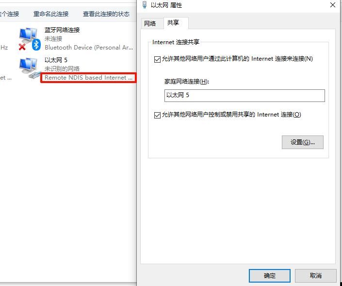

To ensure that you can use the network properly, share the network to Remote NDIS based Internet Sharing Device.
