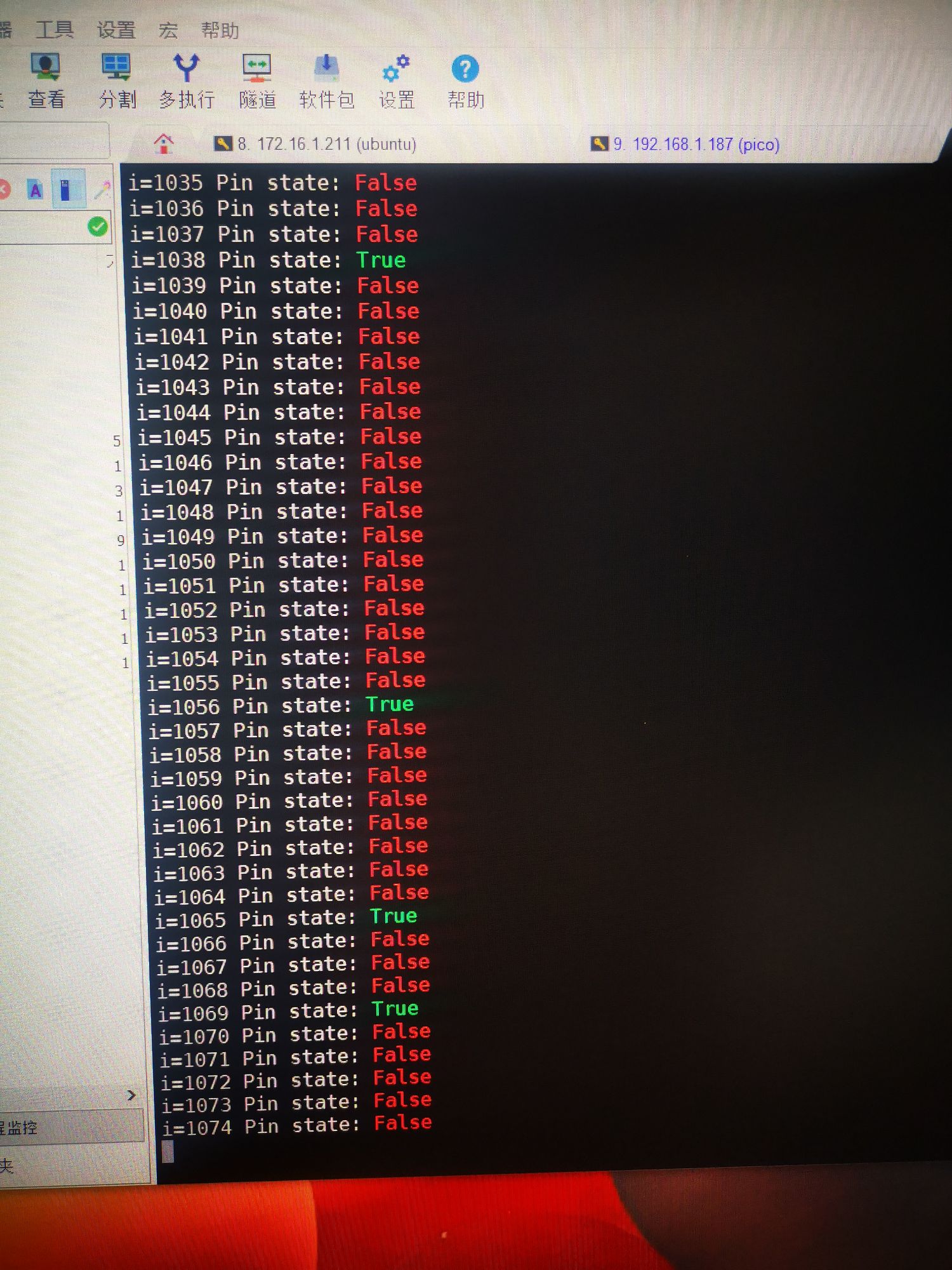

各位大佬,能否帮忙看下这个GPIO 输入问题。
from periphery import GPIO
import time
Write_Pin = 55
Read_Pin = 54
Write_GPIO = GPIO(Write_Pin, "out")
Read_GPIO = GPIO(Read_Pin, "in")
i = 1
try:
while True:
try:
#Write_GPIO.write(True)
#pin_state = Read_GPIO.read()
#print(f"Pin state: {pin_state}")
#Write_GPIO.write(False)
print(f"i=%d Pin state: {pin_state}"%i)
time.sleep(1)
i = i+1
except KeyboardInterrupt:
break
except IOError:
print("Error")
finally:
Write_GPIO.close()
Read_GPIO.close()
关于GPIO的输入怎么不稳定,悬空测试一会儿true 一会儿false

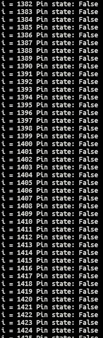

您好,这是我在 luckfox-pico plus 进行测试的结果,使用您的代码没有复现您的问题。 在硬件上如果有焊接排针请检查是否是因为引脚短接;baiye009 wrote: ↑2024-03-06 4:13 各位大佬,能否帮忙看下这个GPIO 输入问题。
import time
Write_Pin = 55
Read_Pin = 54
i = 1
try:
while True:
try:
time.sleep(1)
i = i+1
break
except IOError:
print("Error")
finally:
Write_GPIO.close()
Read_GPIO.close()
在软件上如果有配置设备树请检查是否是设备树设置问题;
希望这能帮助您解决问题。
感谢您的回复,我这边排查一下
