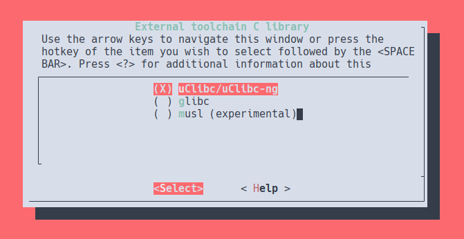

    I assume the issue comes from missing UCLIBC_HAS_LIBINTL=y option from uclibc configuration. I have found out that the file (buildroot)/package/uclibc/uClibc-ng.config has the required option set, however to my understanding buildroot has been configured to use external uClibc provided by the toolchain.
    (toolchain)/arm-rockchip830-linux-uclibcgnueabihf/arm-rockchip830-linux-uclibcgnueabihf/sysroot/usr/lib/uclibc_nonshared.a
    (toolchain)/arm-rockchip830-linux-uclibcgnueabihf/arm-rockchip830-linux-uclibcgnueabihf/sysroot/lib/libuClibc-1.0.31.so
    Is it possible to build my own version of uClibc with intl enabled or solve the issue in other way?
