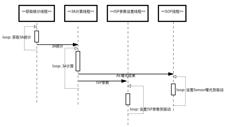

    Just as you speculated,the issue you encountered with dark image capture in the example code seems to stem from the loading of the ISP algorithm on the VI pipe, rather than being an encoding problem.
    While it's possible to set venc to receive single images in the example code, VI captures images in a stream format independently of venc.
    Therefore, when loading the ISP algorithm, it doesn't process individual frames but rather the entire stream. The ISP algorithm documentation (unfortunately, only available in Chinese) indicates that after 3A statistics and 3A calculations, exposure parameters are updated to the sensor driver. Consequently, the exposure parameters for the first few frames captured by VI are not properly set, resulting in darker images.

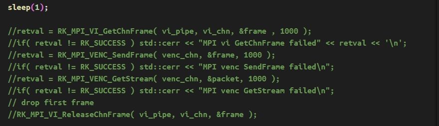

    The solution is to introduce a delay or manually skip the initial frames.
    sleep(1);
    or
        for(int i = 0 ;i < 6;i++)
            retval = RK_MPI_VI_GetChnFrame( vi_pipe, vi_chn, &frame , 1000 );
            if( retval != RK_SUCCESS ) std::cerr << "MPI vi GetChnFrame failed" << retval << '\n';
            RK_MPI_VI_ReleaseChnFrame( vi_pipe, vi_chn, &frame );
