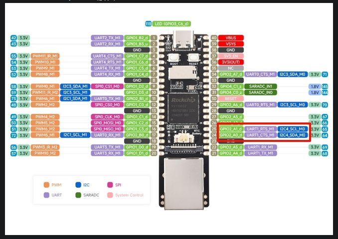

  • rhoki wrote: 2024-04-16 0:10 Hello, I wanted to use i2c4 pins on Pico Pro Max board. I connected the device and ran i2cdetect. It finished fast and only shown some reserved address at 0x30. Detect on i2c3 ran normally. After checking board configuration I discovered, that only i2c3 is enabled in rv1106g-luckfox-pico-pro-max.dts file.

    Can I configure i2c4 pins for my use without worry? Can I just copy the configuration from i2c3, or should I do some additional configuration?
    Hello, if you need to configure the i2c4 pin, you'll have to add the relevant i2c4 configuration in the corresponding dts file.

  • Thank you for the reply.
    So in order to have two sets of i2c pins exposed I will have to use I2c1m1 and one of the i2c3, m0 or m1. Both i2c3m0 and i2c3m1 will not work, is that correct?
  • rhoki wrote: 2024-04-16 10:45 Thank you for the reply.

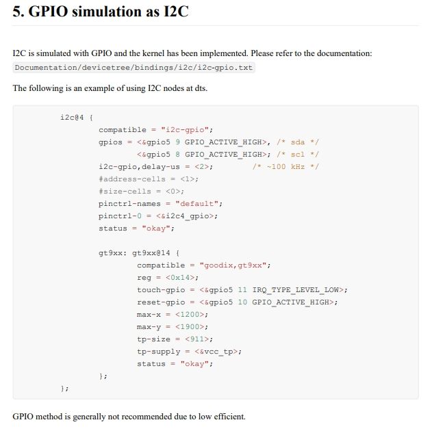

    Yes, when using i2c3, you can only select one set of pins (m0/m1) for multiplexing. However, typically, utilizing chip select pins allows you to connect multiple devices to the same i2c interface simultaneously, which may be a preferable option. Of course, if you have high real-time requirements but don't need to achieve the maximum frequency of I2C, you can also use GPIO to simulate I2C, as mentioned in the Rockchip documentation.
