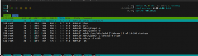

Run 'htop' to check background processes and identify files consuming a significant amount of memory. If certain processes like Samba and Python are not essential, consider temporarily terminating their associated processes. Afterward, observe the system's performance.

Humm .. Got it down to as low as possible and I still have this problem. Im not sure now if i am missing Lib or something
