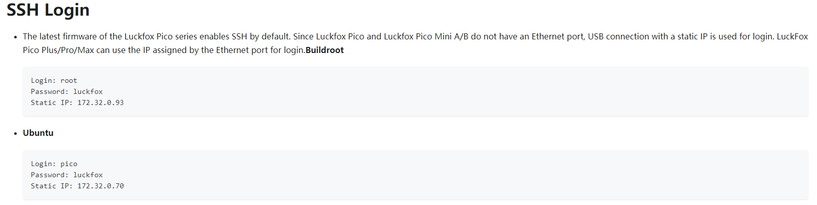

Would you update your instructions to reflect WIN11 as OS. Currently
USB and Ethernet are not functional. Only UART login is possible.
What is user name and password that work.
Network login
Certainly, you can also use ADB (Android Debug Bridge) for login. To install ADB on the Mac terminal, you'll need to use Homebrew, a commonly used package manager.Regarding login names and login passwords, please refer to https://wiki.luckfox.com/Luckfox-Pico/SSH-Telnet-Login/.
USB login example not working. Ping no problem via usb. Using putty I get Connection refused.

Please note the default static IP address of the development board.cgulick wrote: ↑2024-01-16 15:18 USB login example not working. Ping no problem via usb. Using putty I get Connection refused.

Through the USB connection, on 172.32.0.93 ? How did you do it ?
Moreover, "172.32.0.100" should be your local machine's IP on the ADB virtual bridge, not the LuckFox Pico's .
I didn't see any ssh nor sshd in /etc/init.d , or in busybox's listing...

edit : There's a typo in the LuckFox Pico wiki, in the MobaXterm screen capture : the address read "172.0.32.93" instead of "172.32.0.93" .
there -> https://wiki.luckfox.com/assets/images/ ... 790e10.png

@Taylor, are you sure this is for the the Pico Mini-B ?
I'm trying to establish a ssh connection on a Mini-B without an SDcard mounted (thus, no ubuntu).
Should I flash a more up-to-date image on the NAND ? Because I ended up doing it with the contents of the "luckfox_pico_mini_b_image-20240119T155206Z-001.zip" archive, using SocToolKit.exe.

My problem was a wrong image reflash...
I used the system image found in "luckfox_pico_mini_b_image-20240119T155206Z-001.zip" , that I took from the "backup" cloud directory...
Wroooong !
I should have used the image found in the buildroot archive from the start ! ( from the "Luckfox Pico/firmware/buildroot/luckfox_pico_mini_b_image" cloud directory ).
Now I have a happy fox running ssh to my Putty session !
