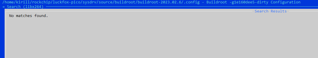

Hello, Crocodile!
I understand this, but buildroot does not have the libx264 module
Using what modules can you record video from a camera by setting the bitrate?
