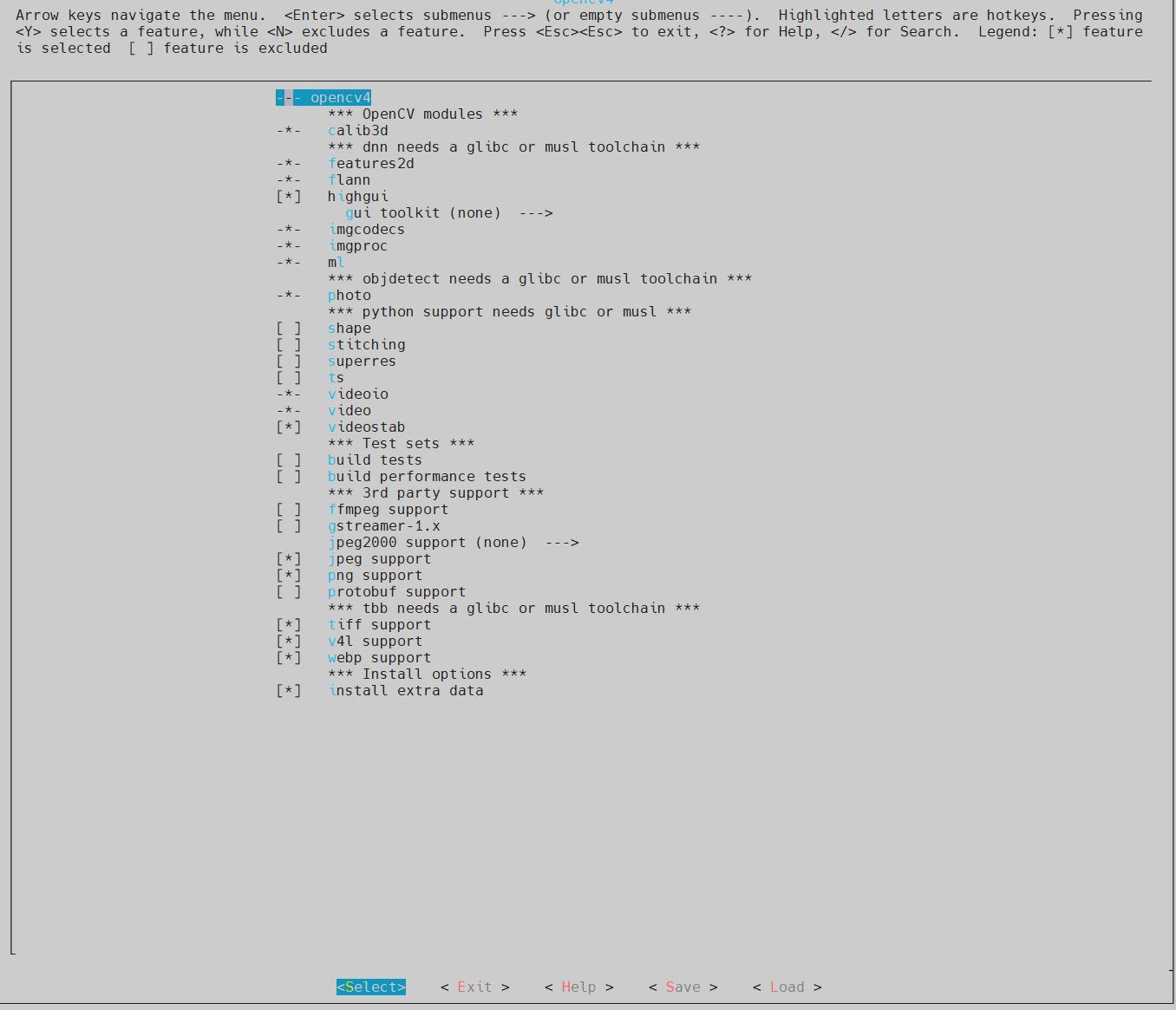

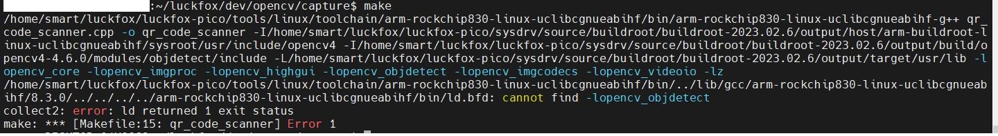

When I try to use the barcode module in OpenCV4, an error occurs in buildroot.
When I check the detailed settings after activating Opencv4 in Target packages -> Libraries -> Graphics, it is displayed as *** objdetect needs a glibc or musl toolchain ***.
I tried installing glibc, but buildroot is set to use a custom toolchain, so I don't know what to do.
How can I solve this problem?
Is it possible to make Luckfox Pico Max recognize QR codes with OpenCV4?
Hello, the version of OpenCV in Buildroot can only support partial functionalities (the luckfox-pico Buildroot compilation tool uses the uClibc version, which is incompatible with glibc). Any OpenCV features that depend on glibc cannot be enabled and will result in the error message "objdetect needs a glibc or musl toolchain." There is currently no reliable solution for enabling glibc support in luckfox-pico Buildroot.
