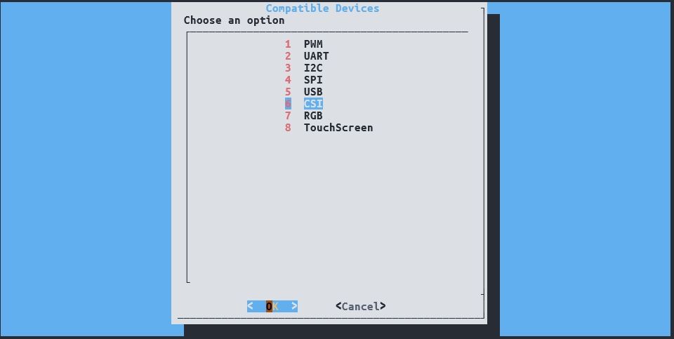

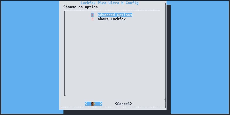

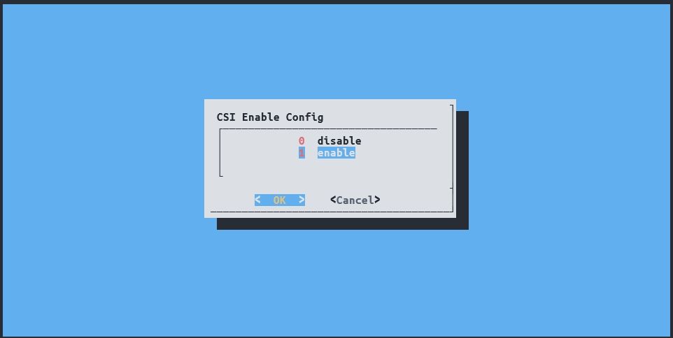

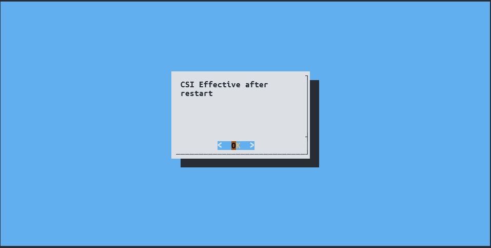

1 Use luckfox-config to open the menuconfig interface.
2 Navigate to Advanced Options -> CSI.
3 Select enable.
4 Restart luckfox-pico.
