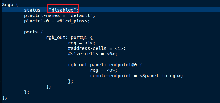

The previous answer contains a correction: the status of uart5 in the DTS must be ensured to be disabled.

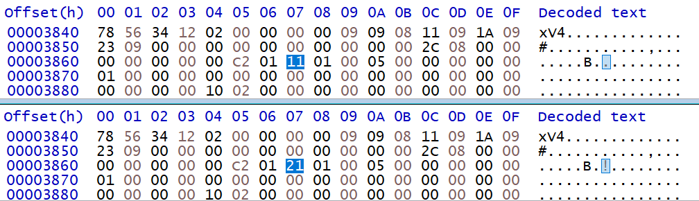

Have a try to change debug port with ddrbin.
Use Pico Max for tests. This board layout have uart1 on same pins that on plus are uart5.
Have dump rv1106_ddr_924MHz_v1.10.bin loader config by ddrbin_tool:
./ddrbin_tool -g dump_params.txt rv1106_ddr_924MHz_v1.10.bin
dump result have expected uart2:
Have change this params in ddrbin_param.txt -
./ddrbin_tool ddrbin_param.txt rv1106_ddr_924MHz_v1.10.bin
Replaced BIN file in /sysdrv/source/uboot/rkbin/bin/rv11 and make clean build.
After that - board loads well and can access by ethernet, but no any bytes from loader on uart1 or other uarts. Other uarts except uart1 are work well under linux.
Have check idblock.img - it have corrected bin with 0x800 offset with changed byte for serial1.
Also have change uboot CONFIG_DEBUG_UART_BASE to 0xff4b0000, it compiles and shows correct serial@ff4b0000 in binary file and same in uboot.img. But uart1 no makes any signs of life. Seems first preloader that after correction of 1 byte in rv1106_ddr_924MHz_v1.10.bin - makes this changes not correct and makes uart1 unavailable for future use in uboot and kernel.
Have check pdf that uart1 on pico max have same mux M1 as on uart2 port. Mux seems correct, but no any preloader boot text on uart after changing by ddrbin util.
Also have test on default firmware that uart1 works OK as /dev/ttyS1. No any wire/hardware problem. Only preloader makes me crying.
Another one strange thing - uart1 don`t pulls up after switching power on (on serial converter led are half-bright), just a second - and it pulls up (led half-bright off) with blinking activity led from kernel. Seems preloder and bootloader don`t access it and uart1 only inits later by dts/kernel/fiq.
Any ideas are welcome.
Alternatively, I can try to make changes to uart3 or uart4, but debug need on this exact pins of uart1 on pico max.

Same manipulations to change uart2 to uart3 - all ok, reloader send all to uart3, same byte have changed from 0x21 to 0x31.
And other uboot and kernel also OK with changes to uart3 just for FIQ, no any other address change or config files.
Seems only uart1 problem in preloader/rkbin.

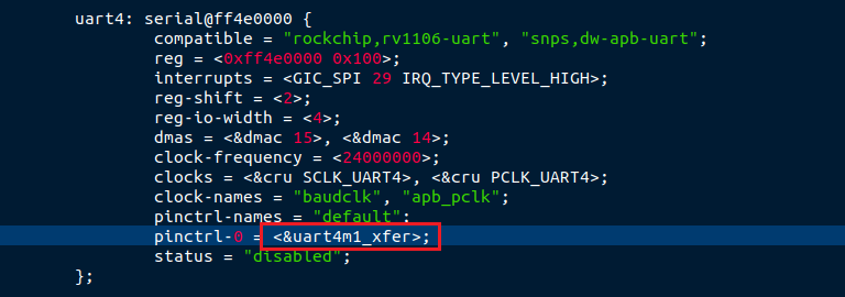

Hey! I've also been trying to change pico console from ttyS2 to ttyS4, and i've changed everything that i was supposed to: uart parameters for ddr.bin, stdout-path in uboot dts:
fiq_debugger in uboot dts (also disabled uart4 in final one):
I've also done the same for linuix kernel dts: changed fiq_debugger to uart4:
and i also disabled uart4 in kernel dts. It makes absolutely no difference for idbloader and u-boot. Moreover, tty console get lost after kernel loading process start. Idk, is there any more configuration parameters to change? Any advice is appreciated, thanks!

Thanks for you reply! Is it the only changes should be applied to dts to globally remap fiq console? I've done a lot of changes starting from ddrbin_param.txt to u-boot dts, u-boot defconfig and kernel dts, but nothing seems to help
The complete process is as follows
Modify ddrbin
1 Navigate to `$SDK/sysdrv/source/uboot/rkbin/tools`
2 Back up the default `.bin` file
3 Modify `ddrbin_param.txt`
4 Modify `ddr.bin`
5 Check if the modification was successful
Modify U-Boot Device Tree
Edit `sysdrv/source/uboot/u-boot/arch/arm/dts/rv1106.dtsi`
Edit `sysdrv/source/uboot/u-boot/arch/arm/dts/rv1106-u-boot.dtsi`
Modify Kernel Device Tree
Edit the corresponding model’s DTS file (located in `$SDK/sysdrv/source/kernel/arch/arm/boot/dts`)
Modify ddrbin
cd <SDK>/sysdrv/source/uboot/rkbin/tools
cp ../bin/rv11/rv1106_ddr_924MHz_v1.15.bin ../bin/rv11/rv1106_ddr_924MHz_v1.15.bin.bak
uart id=4
uart iomux=1
uart baudrate=115200
./ddrbin_tool rv1106 ddrbin_param.txt ../bin/rv11/rv1106_ddr_924MHz_v1.15.bin
./ddrbin_tool rv1106 -g new_ddrbin_param.txt ../bin/rv11/rv1106_ddr_924MHz_v1.15.bin
cat new_ddrbin_param.txt
fiq_debugger: fiq-debugger {
compatible = "rockchip,fiq-debugger";
rockchip,serial-id = <4>;
rockchip,wake-irq = <0>;
rockchip,irq-mode-enable = <0>;
rockchip,baudrate = <115200>; /* Only 115200 and 1500000 */
interrupts = <GIC_SPI 125 IRQ_TYPE_LEVEL_HIGH>;
status = "disabled";
uart4: serial@ff4e0000 {
compatible = "rockchip,rv1106-uart", "snps,dw-apb-uart";
reg = <0xff4e0000 0x100>;
interrupts = <GIC_SPI 29 IRQ_TYPE_LEVEL_HIGH>;
reg-shift = <2>;
reg-io-width = <4>;
dmas = <&dmac 15>, <&dmac 14>;
clock-frequency = <24000000>;
clocks = <&cru SCLK_UART4>, <&cru PCLK_UART4>;
clock-names = "baudclk", "apb_pclk";
pinctrl-names = "default";
pinctrl-0 = <&uart4m1_xfer>;
chosen {
stdout-path = &uart4;
u-boot,spl-boot-order = &sdmmc, &spi_nand, &emmc;
&fiq_debugger {
rockchip,irq-mode-enable = <1>;
status = "okay";
&rgb {
&uart4 {
