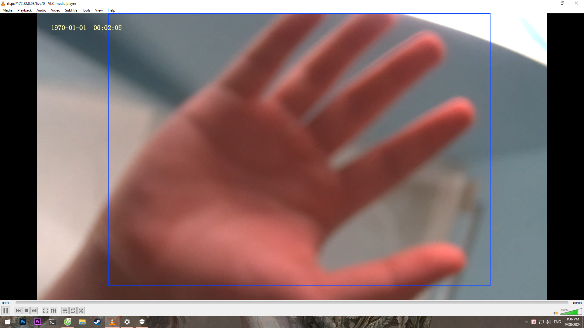

I just bought an SC3336 camera online, but when I use VLC to test the video output, the quality is poor (in image).
The camera only shows good quality when the distance from my hand to the camera is 3-4 cm.
How can I improve the quality?
- Posts: 1501
Hello, there is a knob in front of the sc3336 to adjust the focal length, a suitable focal length can make the image clear, the sc3336 does not have a focusing motor to achieve auto focus, please adjust it according to the actual captured image
- Posts: 19
- Joined: 2024-09-02 16:40
After adjust the focal length, the camera quality is better.
Thank you.
