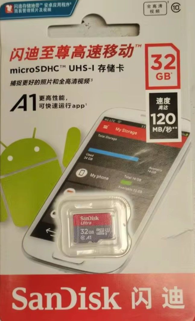

Pico Pro Max bootloader does not "see" SanDisk Ultra 32GB microSDHC UHS-I card with ubuntu image.
Does bootloader support cards more than 8GB? Does it support SDHC or SDXC card types?
Make all by wiki manual, no any errors on format or making sd in SocToolKit.
