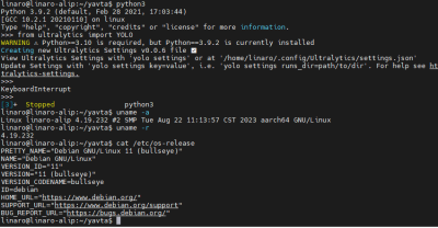

i have upgraded to bullseye:
linaro@linaro-alip:~$ cat /etc/os-release
PRETTY_NAME="Debian GNU/Linux 11 (bullseye)"
NAME="Debian GNU/Linux"
VERSION_ID="11"
VERSION="11 (bullseye)"
VERSION_CODENAME=bullseye
ID=debian
HOME_URL="https://www.debian.org/"
SUPPORT_URL="https://www.debian.org/support"
BUG_REPORT_URL="https://bugs.debian.org/"
but partly ((

i finally did it.
upgraded to bullseye!
i have to change /var/lib/dpkg/info/util-linux.postinst
https://askubuntu.com/questions/1208030 ... 06#1531106
sudo apt -f install util-linux
sudo apt --fix-broken install
sudo nano apt.postinstall - put exit 0; to not to update (just dont want to find out why it breaks)
sudo nano e2fsprogs.postinst - - put exit 0; to not to update (just dont want to find out why it breaks)
