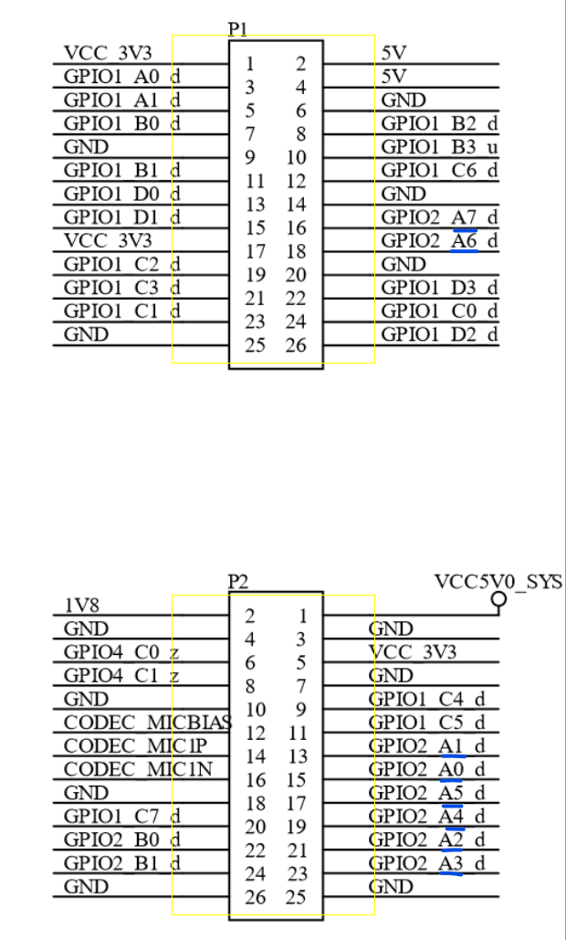

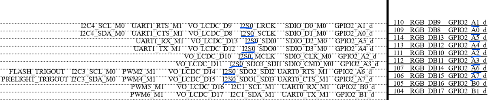

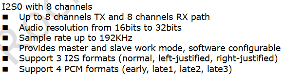

  • Prismo wrote: 2024-11-02 2:45 Hello, am I able to configure the GPIO to receive I2S input? From what I can tell the I2S pins are connected to the GPIO. Is this correct?
    The device I am trying to connect only outputs I2S/DSP.
    You can configure it, you just need to modify the device tree, but only if you make sure that the other multiplexing is off and not conflicting.
