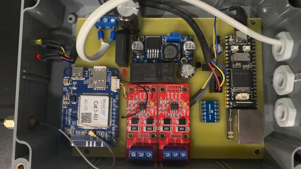

Need to make hardware reset of board and usb modem on it by switching relay with power.
(By default power goes from NC to COM contact on relay, then simple scheme with optocoupler and npn makes relay switch and board lost power and in a few seconds relay back to powering board.)

In a few words - need make daily hardware reset by disabling board power by external relay, for example each day in 2:00 AM.
By now I use script from cron for hardware reset:
Led device named hw_reset connets PC817 with relay, that normal connected and powered board.
Relay have a capacitor and it disable power about 2 seconds, than back powering board. This enough to reset modem and board.
Does it enough "sync" command to properly close FS? What other need to make?
Any ideas are welcome.
Thanks!

Currently, my approach is to use a GPIO pin, let’s say GPIO1_D1, which is initially set to low level. The relay is connected using the normally closed (NC) wiring to GPIO1_D1.
1 When GPIO1_D1 outputs a high level, the relay disconnects the power supply. However, due to the presence of a capacitor, the power supply can still be maintained temporarily.
2 GPIO1_D1 continues to output a high level until the capacitor's power is depleted, causing a hardware-level power cut. At this point, the relay, using the normally closed connection, restores the power supply.
3 After the Luckfox Pico restores power, it reboots and enters the system again.
Your concern seems to be about the risk of improper power-off and restart potentially compromising the stability of the file system. While we haven’t conducted industrial-grade testing, and in daily use, the impact of direct power-off is minimal, it still cannot be ignored. Therefore, my solution is to delay the GPIO1_D1 high-level output to the final stage of the restart process.
On the RV1106, the shutdown or reboot process will invoke the /etc/init.d/rcK script to close related hardware or background services. The system executes /etc/init.d/S* stop scripts in sequence by numerical order. Hence, a custom script can be created as /etc/init.d/S99custom.
