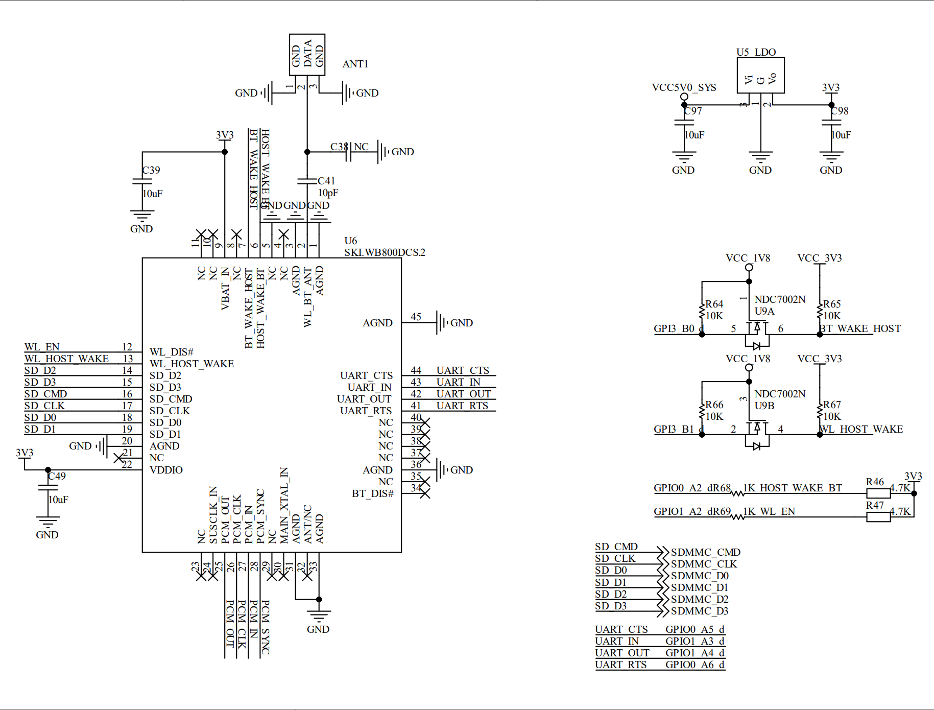

I recently ordered the Core1106 board.. size and specifications are very impressive.
However I want to modify the unit to have 5ghz wifi chip... its been done before with the nanopi duo 2 with modified driver but in pictures the wifi chip has no markings on it.. do you know what wifi chip it is? I want to modify it to find pin compatible chip.
I dont want to wait for the shipment to arrive as wifi chip orders take a lot of time.. does anyone have a picture of the board with the wifi chip markings still on it?
Thank you!
What is the Core1106 wifi chip ?
The chip model is SKI WB800DCS.2, The schematic diagram is as follows:
https://files.luckfox.com/wiki/Luckfox- ... ra%20W.pdf
Schematic diagram link:thank you! ill try to see if i can make an interface board to adapt it to a different wifi chip that does 5ghz
