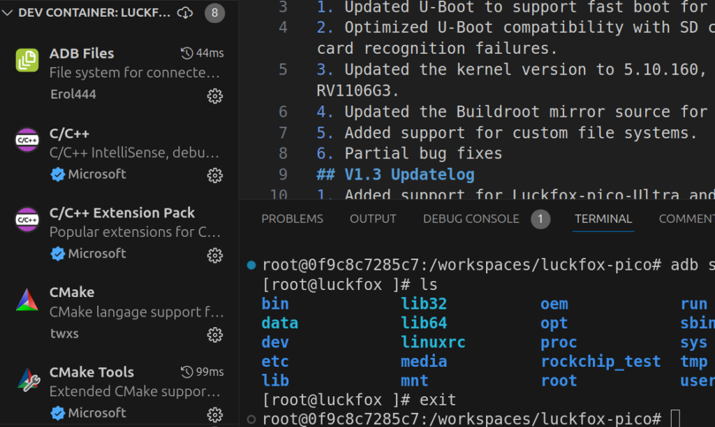

3.已配置容器特权模式,设备映射,支持热拔插USB,可以使用ADB方便传文件,在自己项目中的build.sh 中就使用ADB进行上传和测试。该容器环境也支持直接运行rkflash.sh进行烧写.
The container runs in privileged mode. And we map the host /dev folder to the container /dev folder. So you can easily use ADB even within dynamically plugged USB devices. The script rkflash.sh can also work. 4. 可选按F1配置ADB文件管理,进入基于adb的图形化文件管理,选择AdbFS: Setup Android ... Workspace,忽略重新加载窗口。如果切换文件夹并且不保存工作区,ADB file会自动关闭,可以再次按F1启动.

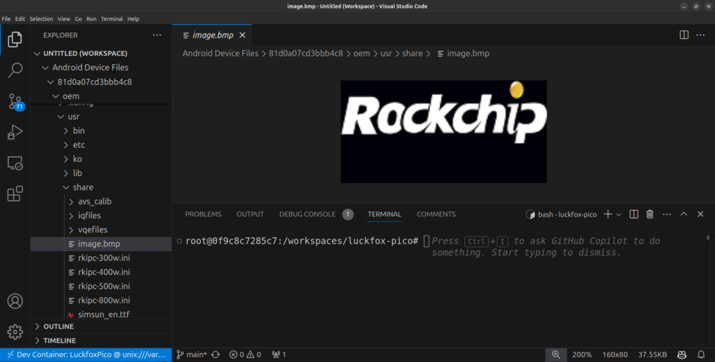

You can press F1 to active AdbFS to preview the pictures or download the files. I recommend not saving the workspace and activating AdbFS again to prevent potential ADB problems when you are switching folders.
即可方便地预览照片
Preview the picture in an elegant way. 5. 容器已经安装部分插件,可以更方便进行项目配置和代码编写。可以修改devcontainer.json的"extensions":进行个性化,添加插件时使用插件ID 比如mutantdino.resourcemonitor。

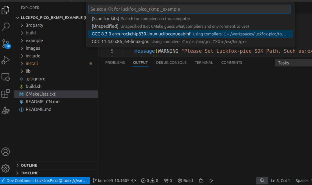

6. 已配置SDK交叉编译和wiki RKMPI示例所需的环境变量,因此make相关插件可检测到工具链并正常工作。可以在SDK目录下新建项目并打开项目文件夹作为临时工作区。图片以wiki RKMPI例程为例。因为ADB file插件会修改工作区,因此切换文件夹时可能会询问是否保存,选否即可。
The environment variables required for SDK cross-compilation and the RKMPI example in Wiki have been configured. So, you can switch to your project folder(in the SDK folder) in the container with the installed toolchain. Because the ADB file plugin modifies the workspace, you may be prompted to save changes when switching folders. Simply select 'No'. Here are RKMPI examples in Wiki for reference.
可以看到make插件可以正确识别工具链,意味着工具链安装成功(因为部分环境变量,因此这不意味着make完全工作)。
You can see that the Cmake plugin recognizes the toolchain, which means the toolchain is successfully installed (though due to partial environment variables, this doesn't necessarily mean Cmake will work completely). 尝试编译

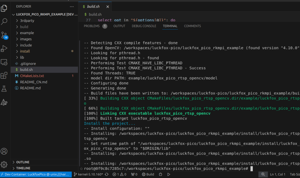

Compiling
成功
Successful!
