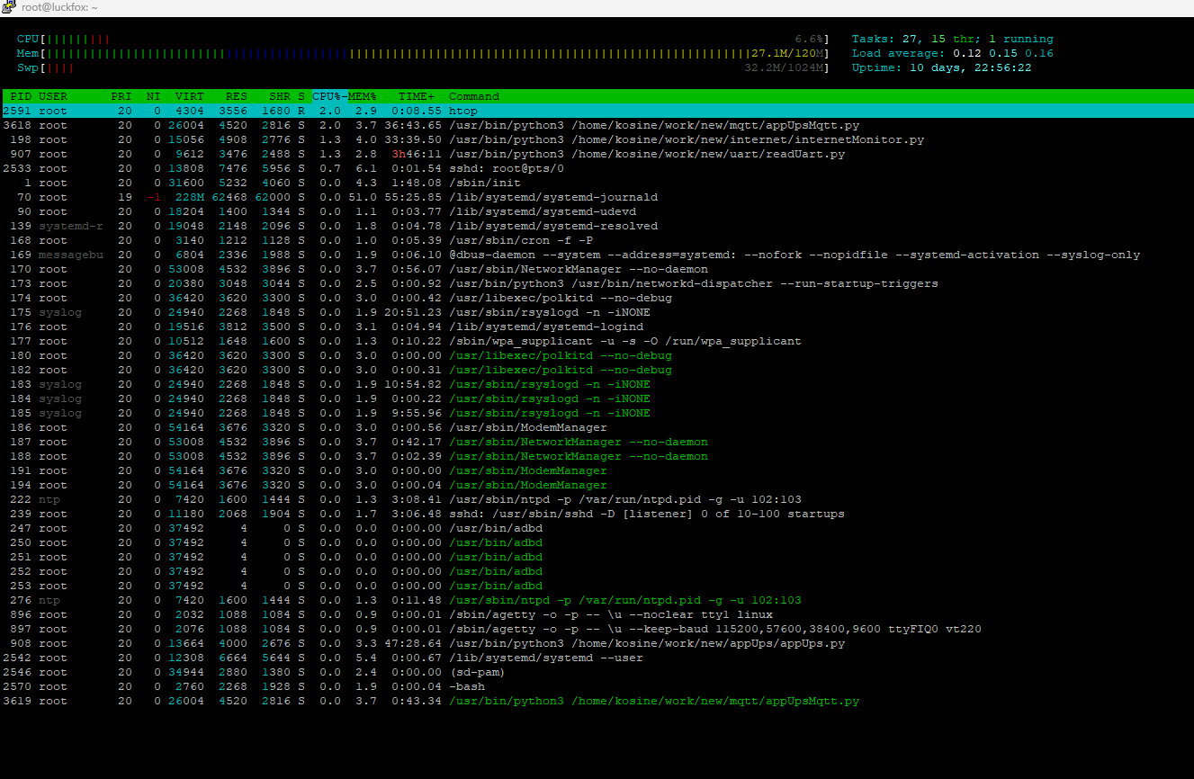

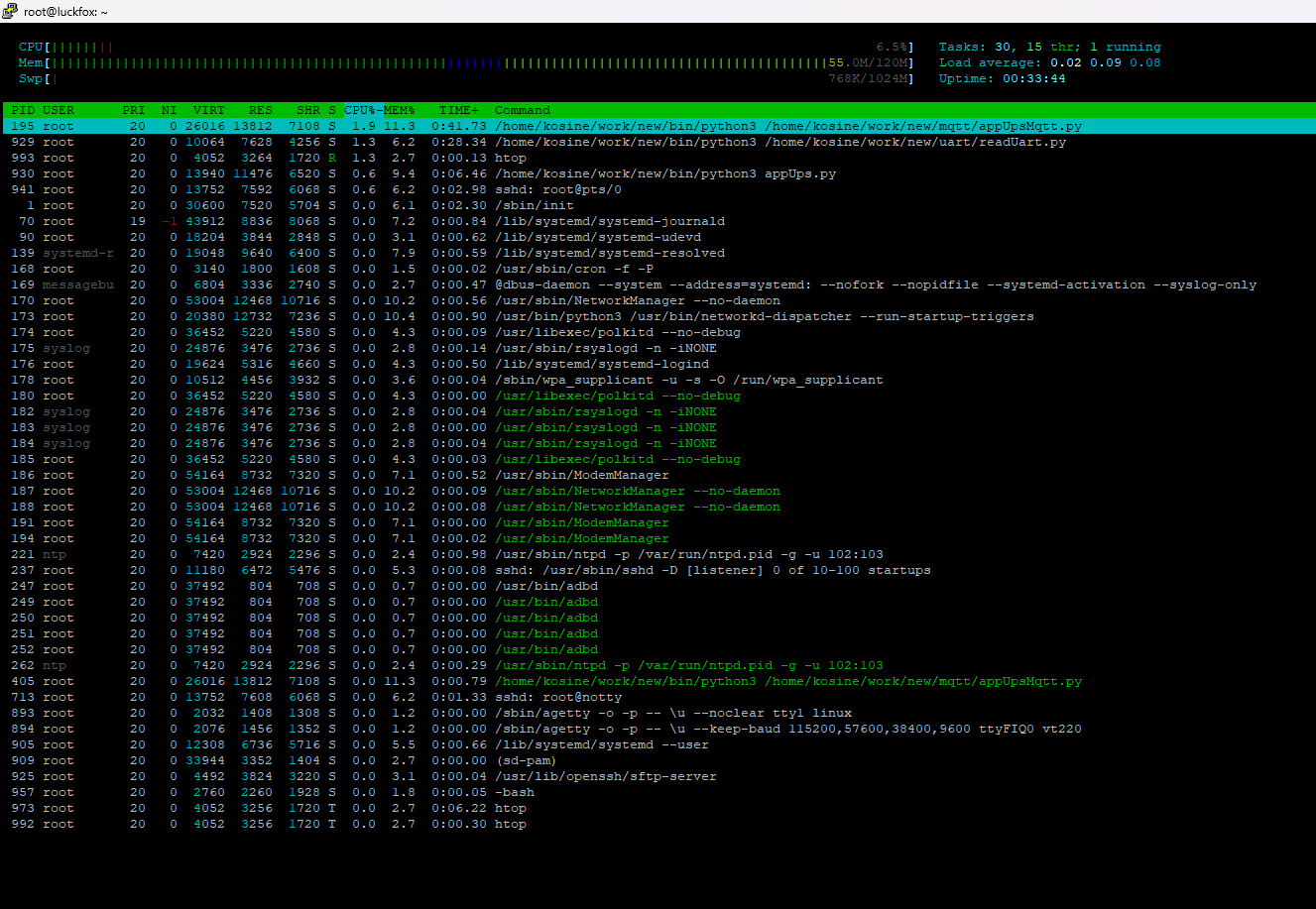

1 Memory problem: You can see the difference through the image is mainly the occupation of the python file you write, when the MQTT program is running, due to the requirements of the network environment, the memory occupation of the NetworkManager is also increased, if you want to reduce the memory occupation, you can only try to optimize your program
