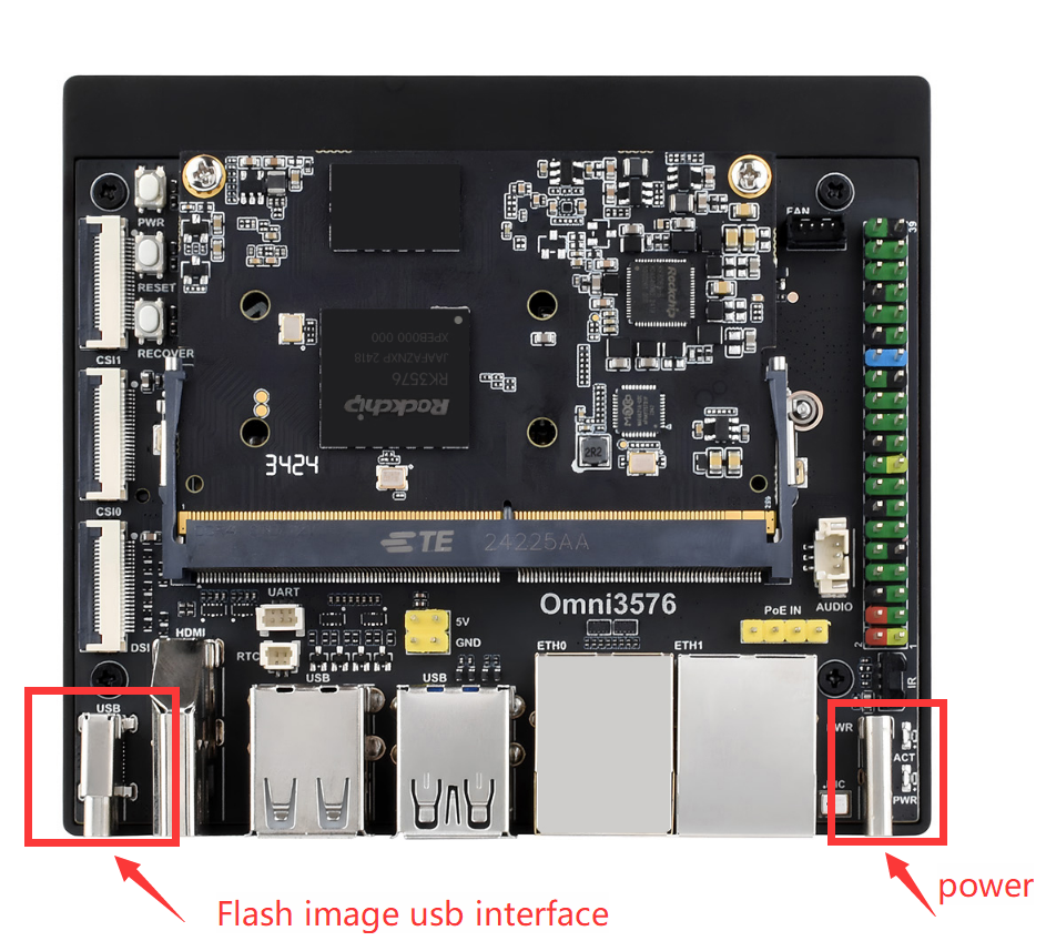

Hello,
First, ensure you have connected both the download cable and power supply.
Second, follow the steps in the wiki:
https://wiki.luckfox.com/luckfox-Omni35 ... grade-mode
Press and hold the RESET button, then press and hold the RECOVERY button.
Release the RESET button while keeping the RECOVERY button pressed.
Release the RECOVERY button once the device is recognized in LOADER mode.
If the device still isn't detected, short the ADC0 and GND pins on the development board. This will force the board into burning mode.
Let me know if you need further clarification!

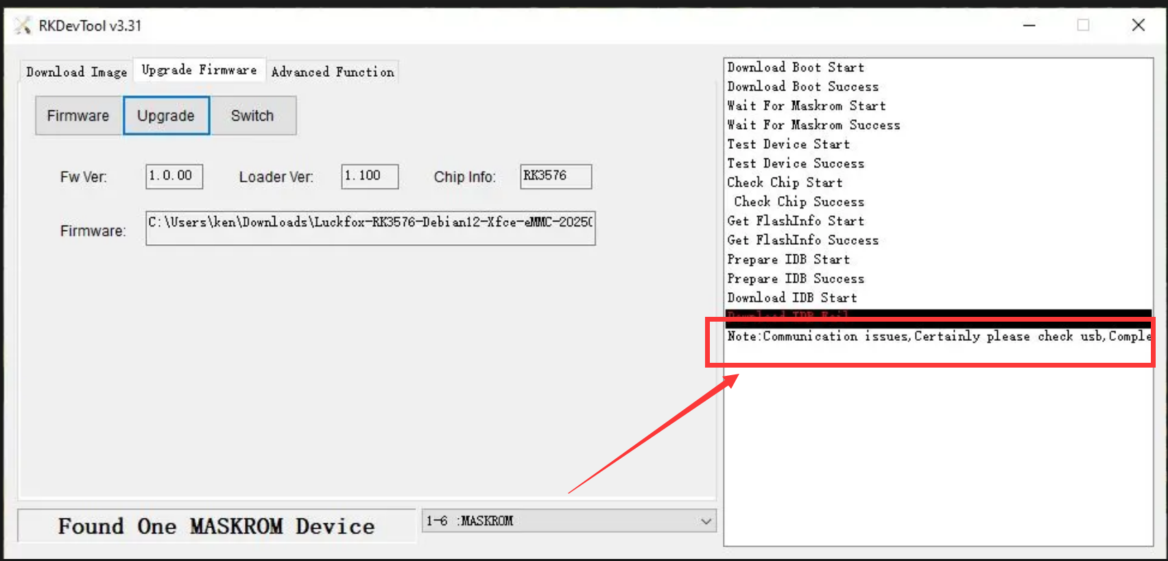

- Posts: 5
- Joined: 2025-03-13 15:21
This is the screenshot of the IDB download failure:
- Posts: 333
- Joined: 2023-12-09 3:09
The error message you're seeing is likely due to communication issues caused by problems with the USB cable or computer port. You can try changing the cable, using a different USB port, or switching to another computer—these steps should resolve the issue.
- Posts: 5
hi Sir,
I already change 3 usb cables (bought 2 new data cable), using 2 laptop and 1 desktop connect all usb ports.
Results still the same. All stop at download IDB fail.
I wonder why it download boot success usb no problem, but when download IDB, usb problems?
