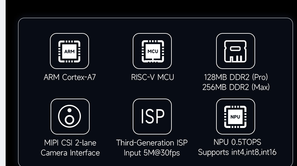

The datasheet mentions 512MB of DDR2.
I think it's likely that distributors are obtaining this information directly from the datasheet for sales purposes. As for the 1GB NAND, I believe that's the point worth paying attention to. However, looking at the official store for the LuckFox Pico Plus, there's only one version available, 64MB of RAM and 128MB of NAND. It's best to purchase from official channels.
Hi, these data were taken from the official LuckFox website and it appears to be a version with 512 DDR2 and 1GB of SPI Nand Flash.

Due to the fact that we initially used the data directly from the chip manual, many customers misunderstood this. It's actually a difference in units, not deception. It's the famous distinction between big B and small b. Generally, in communication, we use small b, meaning bits. 8 bits make a byte, called Byte, which is big B.
1Gb = 1024M bit = (1024\8) M = 128M;
