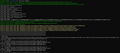

    When running ./build.sh firmware I have noticed some warnings coming from the script. Could that have something to do with my issues?
  • Please make sure that the package you have enabled has any libraries or binaries available, and check for files under ${SDK}/output/out/rootfs_uclibc_rv1106 before executing ./build.sh firmware
    The warning content you provided has nothing to do with the package not being installed correctly and can be ignored

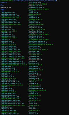

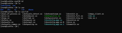

    All packages I selected are available in the buildroot config after download the SDK. I can also see them under ${SDK}/output/out/rootfs_uclibc_rv1106/usr/lib (see attatchment)
    But after flashing, they cannot be found in the same location on the board's filesystem
