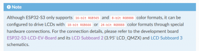

You can refer to the description of https://docs.espressif.com/projects/es ... _lcd.html , the main difference between the different models of RGB screens is that the initialization is different, and the data format during transmission is similar

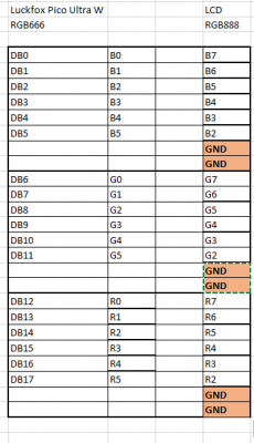

I checked and show mapping btw LCD connector on Luckfox Pico Ultra W to 40 pin LCD as the below:
Could you please help to review and confirm?
Thank you.
I am sorry, but i can only provide suggestions regarding third-party hardware designs or adapters. We are not in a position to take responsibility for the results, and therefore we cannot offer review or confirmation. Please make your own judgment. Thank you for your understanding.

Yes, I understand this.
I used Luckfox Pico Ultra W dev board for customer product, so i hope that i can get the supporting from you( Luckfox engineer)
So, for the final could you please help to confirm about RGB bit order on LCD connector LuckFox Pico Ultra W?
DB0-DB17 on H2 connector on Luckfox Pico Ultra W will mapping with B[0:5]-G[0:5]-R[0:5] or B[5:0]-G[5:0]-R[5:0].
Thank you.

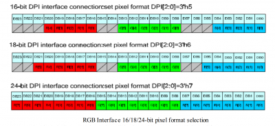

Referring to this image, your speculation should be correct
