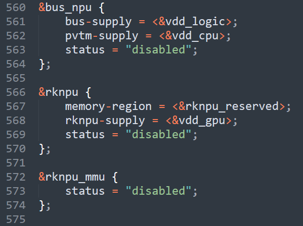

Buildroot Configurations for RKNPU and Camera
SDK/kernel/arch/arm64/boot/dts/rockchip/core3566-luckfox-rk3566.dtsi
The status should be changed from disable to okay.
