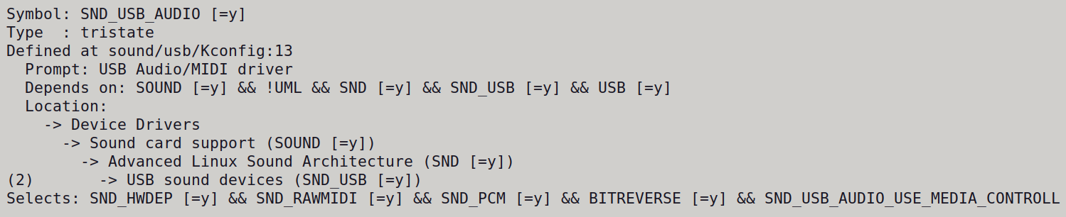

    okay so summarize it all, i need to take sdk from github, then enable snd audio in the kernel and write the image to sd card, and then connect the usb audio device to type c port of board (im sorry im new to this)
  • You have no problem with your implementation idea, and this method is also suitable for making SPI NAND images
