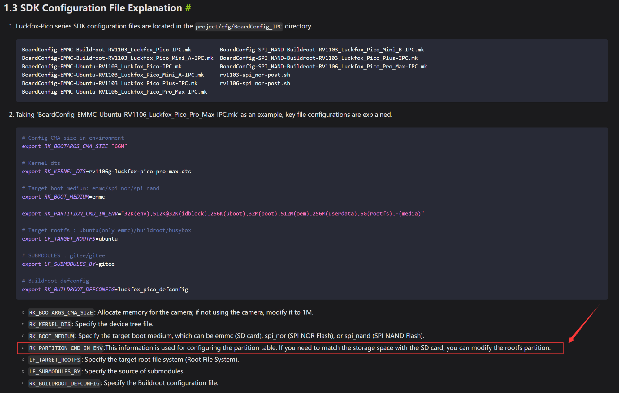

Hi guys. I flushed 32 Gb SD card according to instruction. All works perfect, but summary size of all partition is around 6 Gb. How can I resize root partition to all free space on SD card optimally? Thanks in advance.
Hello,
If you need to match the storage space of the SD card, you need to modify the configuration file of the corresponding development board, as introduced in the wiki:
