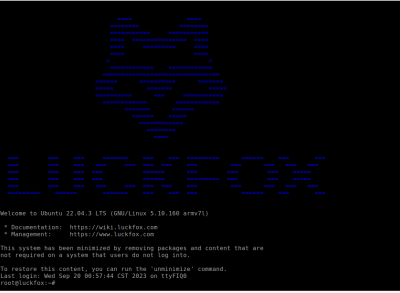

Run GTK w/8 1 N/115200 as per:
https://wiki.luckfox.com/Luckfox-Pico/L ... Login-UART

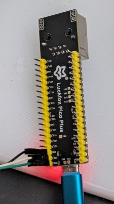

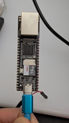

- I tried 2 different USB C cables..
I do not get a response from the device.
Here's a pic of the device and gtkterm:
