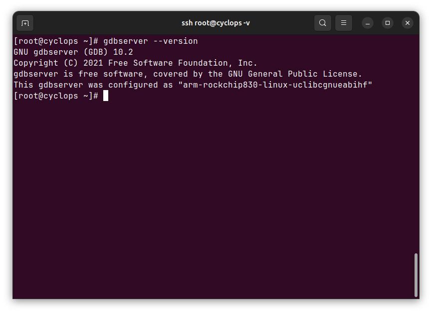

"label": "remote gdbserver",
"type":"shell",
"command": "sshpass",
"options": {"cwd": "${workspaceFolder}"},
"args": [
"-p",
"luckfox",
"ssh",
"root@cyclops",
"cd /root && LD_LIBRARY_PATH=/oem/usr/lib:/oem/lib gdbserver :1234 ./cyc"

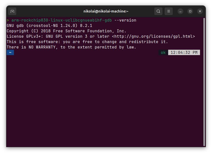

"miDebuggerPath": "arm-rockchip830-linux-uclibcgnueabihf-gdb", // gdb for target
