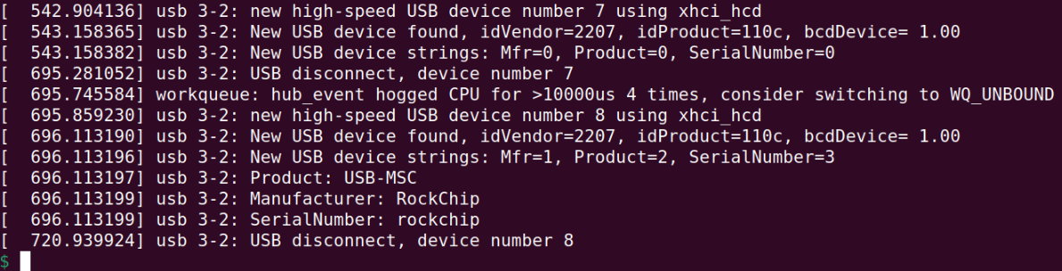

- Hold Boot button while connecting Board to USB
- check with `lsusb` (refer to https://wiki.luckfox.com/Luckfox-Pico/L ... Burn-Image)
$ lsusb
Bus 004 Device 001: ID 1d6b:0003 Linux Foundation 3.0 root hub
Bus 003 Device 027: ID 2207:110c Fuzhou Rockchip Electronics Company

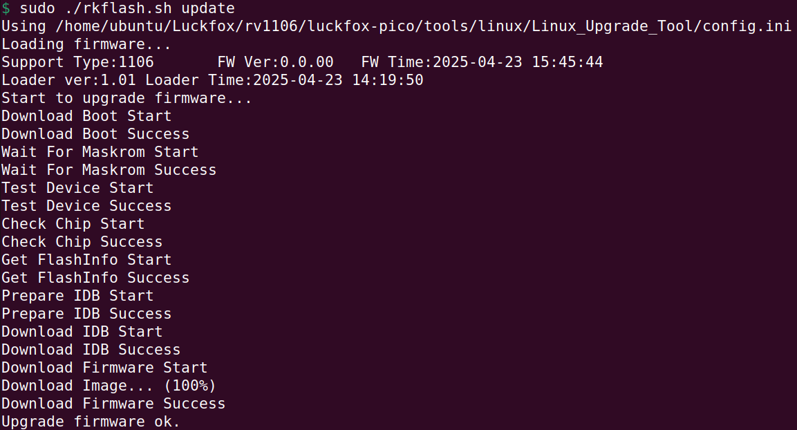

./luckfox-pico$ sudo ./rkflash.sh update
[sudo] password for user:
Using ./luckfox-pico/tools/linux/Linux_Upgrade_Tool/config.ini
Loading firmware...
Support Type:1106 FW Ver:0.0.00 FW Time:2025-03-13 10:07:02
Loader ver:1.01 Loader Time:2025-03-13 10:05:39
./rkflash.sh: line 96: 1505574 Segmentation fault (core dumped) $UPGRADETOOL uf $UPDATE
