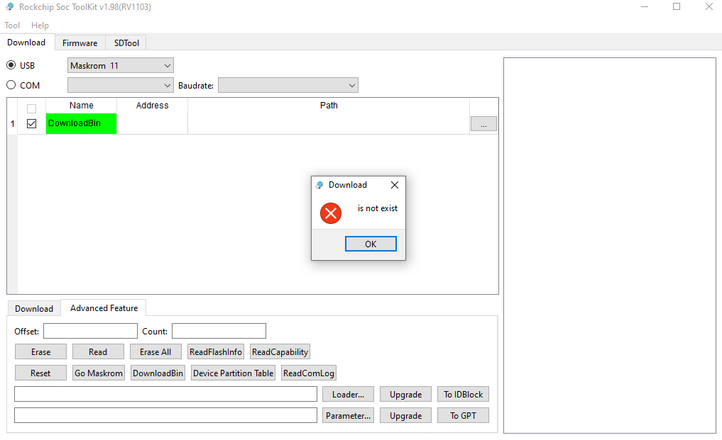

I have a Pico Plus and I want to install Ubuntu or another type of Linux on the SD card.
However, I encountered a problem while going through the step-by-step guide.
When I try to erase the flash, I get this error code after clicking on DownloadBin.
Can someone help me or tell me where this error comes from?
Problems with Erasing SPI NAND Flash
Hello, you need to pass in download.bin to perform the clearing operation. You can select the directory of the cloud disk image and check download.bin. First, click the button "DownloadBin" and then click "Erase All". Refer tohttps://wiki.luckfox.com/Luckfox-Pico/L ... urn-image/
By default, the boot priority of SD is higher than that of SPI NAND, and it is not necessary to clear the boot using SD card
