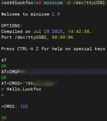

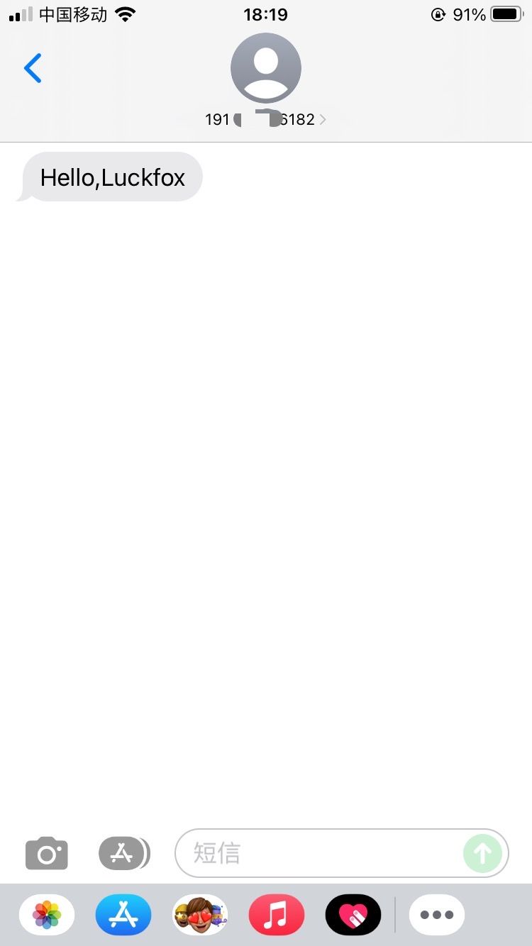

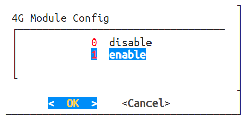

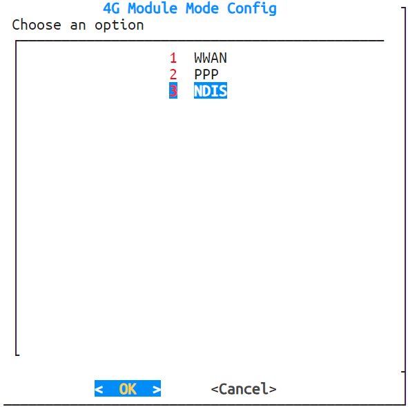

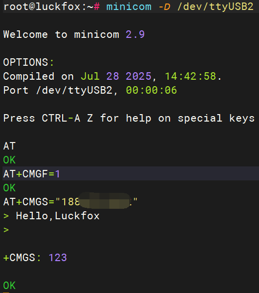

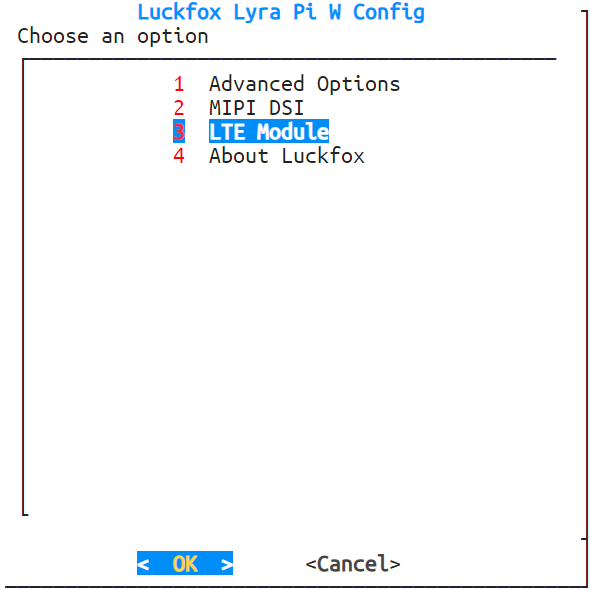

Our development board, when paired with the SIM7600H - G module, can send SMS normally in RNDIS mode. The specific steps are as follows:
1. Switch to RNDIS using luckfox - config. 2. Open minicom to send the SMS. 3. The SMS is sent successfully.
