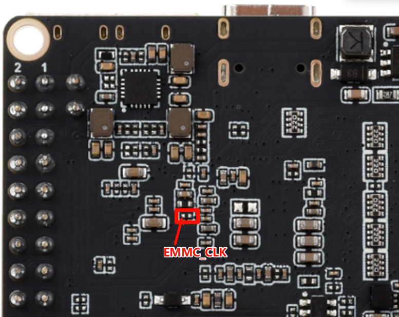

[Pico Ultra W] Can NOT recovery using button BOOT
  • Hello, the recovery button detection is completed during the U-boot stage. If U-boot fails to run, the button detection cannot be performed. To achieve this, you need to short the CLK pin of EMMC and GND, then power on to force the Pico Ultra W into MASKROM mode for burning the new image.
    Please note that this operation involves risks. Please proceed with caution.
