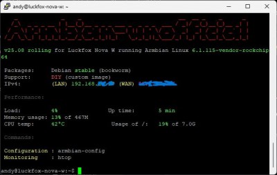

  • NovaUserUK wrote: 2025-08-29 22:13 Keep an eye on this pull request:
    https://github.com/armbian/build/pull/8306
    I managed to manually merge the changes with my local Armbian build environment and produced a working image:
    Downloading and installing new packages seems a little slow but I managed to get Docker with Portainer running. When I'm back at work I'll try out some of our production images :)
    Will the eMMC work?
