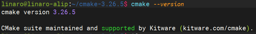

cmake --version
3. 解压并赋予文件权限
tar -xvzf cmake-3.26.5.tar.gz
cd cmake-3.26.5
sudo chmod 777 ./configure
sudo apt update
sudo apt install g++
libssl-dev -y
export OPENSSL_ROOT_DIR=/usr/include/openssl
./configure
#运行结果
Cmake has bootstrapped. Now run make.
make
sudo make install
sudo update-alternatives --install /usr/bin/cmake cmake /usr/local/bin/cmake 1 --force
cmake --version
