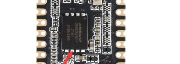

i used rkflash.sh in the sdk for flashing firmware for Luckfox pico plus, maybe my firmware has some problem then the board cannot boot in kernel. Please help me how to flash default image. now PC cannot detect usb (lsusb) - enter download mode. This is log via uart:
