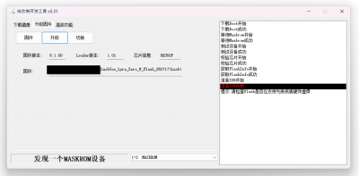

I accidentally flashed a luckfox lyra firmware to the luckfox lyra zero w, which aborted mid-way with something like "partition size too small". Now the device is no longer recognized on my PC. I tried entering maskrom mode by shorting on of the pins of the flash chip as described in the luckfox lyra documentation, which results in the following output in linux:
[ 793.291945] usb 1-3.3: USB disconnect, device number 13
[ 1043.069003] usb 1-3.3: new full-speed USB device number 14 using xhci_hcd
[ 1043.142042] usb 1-3.3: device descriptor read/64, error -32
[ 1043.318943] usb 1-3.3: device descriptor read/64, error -32
[ 1043.495020] usb 1-3.3: new full-speed USB device number 15 using xhci_hcd
[ 1043.568038] usb 1-3.3: device descriptor read/64, error -32
[ 1043.743050] usb 1-3.3: device descriptor read/64, error -32
[ 1043.846123] usb 1-3-port3: attempt power cycle
[ 1044.432902] usb 1-3.3: new full-speed USB device number 16 using xhci_hcd
[ 1044.433108] usb 1-3.3: Device not responding to setup address.
[ 1044.638150] usb 1-3.3: Device not responding to setup address.
[ 1044.845991] usb 1-3.3: device not accepting address 16, error -71
[ 1044.846080] usb 1-3.3: WARN: invalid context state for evaluate context command.
[ 1044.918991] usb 1-3.3: new full-speed USB device number 17 using xhci_hcd
[ 1044.919093] usb 1-3.3: Device not responding to setup address.
[ 1045.126165] usb 1-3.3: Device not responding to setup address.
[ 1045.333968] usb 1-3.3: device not accepting address 17, error -71
[ 1045.334061] usb 1-3.3: WARN: invalid context state for evaluate context command.
[ 1045.334120] usb 1-3-port3: unable to enumerate USB device
