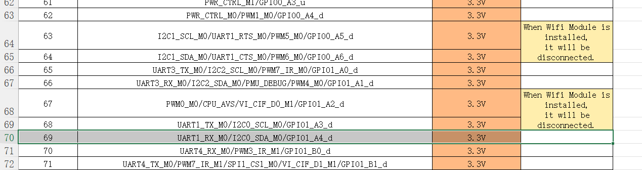

    We're using the Core1106 with Wifi so this is likely the issue. We did go and re-check your documentation and it's not marked as disconnected in the pinout excel Image. We do see it's connected now in the schematic but this should probably really be marked correctly in the pinout as well.
  • I'm sorry, it seems that there was an error in the document organization. The correct information should be: GPIO1_A3 and GPIO1_A4 are not connected, while GPIO1_A2 is connected. I informed the relevant colleagues to make the corrections.
