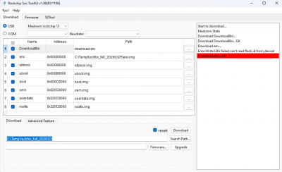

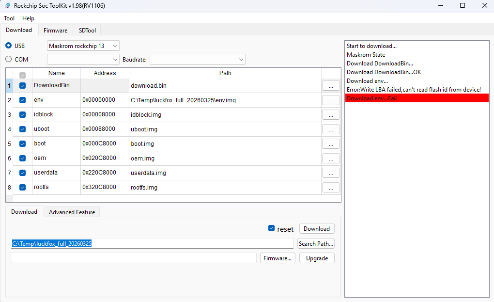

Ok, I’m encountering an issue while uploading the image. Every time I try to upload it, it always fails at this point.
"Error:Write LBA failed,can't read flash id from device!"
Download env...Fail
I tried with different boards and different USB cables. The connection is direct, without a hub.

Have any of the other RV1106 models been successfully upgraded through burning?
A damaged driver could also be the cause of this issue. You can try reinstalling the driver.
Hi,
Just to update you: I managed to flash everything correctly. Most likely, the issue was the driver, which I uninstalled and reinstalled.
