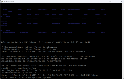

OS: Official Luckfox Debian 12 (bookworm)
Kernel: Linux luckfox 6.1.75 #4 SMP Fri Jan 30 10:30:35 CST 2026 aarch64

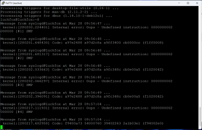

Looking at the syslog and journalctl -k -b -1, the system throws a Kernel Panic related to a Level 2 translation fault:
Message from syslogd@luckfox ...
kernel:[ 449.395298] Internal error: Oops: 0000000086000006 [#1] SMP
kernel:[ 449.887719] Code: bad PC value
Unable to handle kernel paging request at virtual address ffffffc005675e0c
Mem abort info:
ESR = 0x0000000086000006
EC = 0x21: IABT (current EL), IL = 32 bits
FSC = 0x06: level 2 translation fault
CPU: 2 PID: 2338 Comm: chromium-bin Tainted: G O 6.1.75 #4
Call trace:
vm_unmapped_area+0x2a0/0x2d0
do_mmap+0xe0/0x484

Result: Immediate VNC disconnection and complete system lockup. The SSH terminal caught the following syslog broadcast before dying:
Message from syslogd@luckfox at Mar 22 21:34:32 ...
kernel:[ 337.276321] Internal error: Oops: 000000009600004e [#1] SMP
kernel:[ 337.671910] Code: eb0000ff 54000069 b5fffee0 f94014c0 (a9010265)- Upgraded power supply to a high-quality, high-amperage unit. (Issue persists, ruling out power dips).
