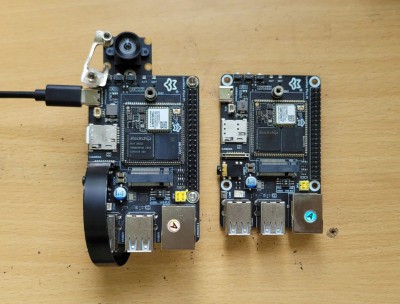

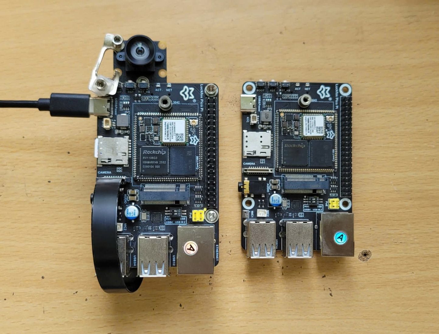

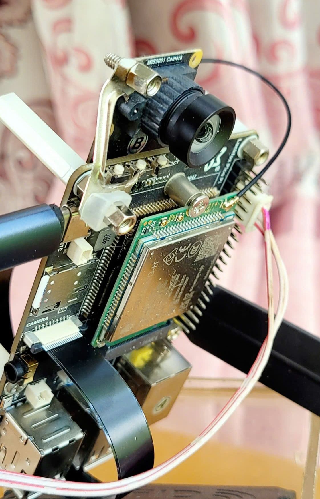

I recently started working with two Luckfox Pico A boards equipped with a 4G module connected to the M.2 slot, along with a MIS5001 camera.

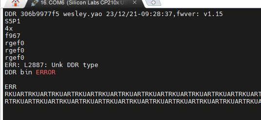

I successfully configured the software so that the boards could connect to the Internet via 4G and stream video. Everything was working as expected. However, both boards suddenly stopped working. They rebooted and then failed to boot properly. The only output I can get from the UART console is:

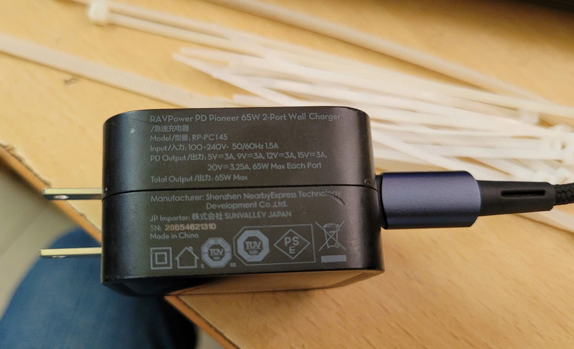

Before one of the boards failed, it reported a power-related error, even though I was using what I believe is a good GaN power adapter.

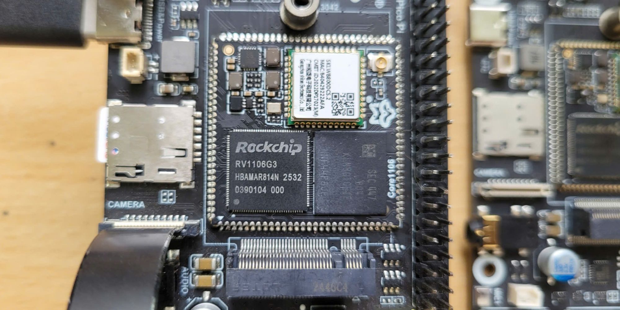

[ 70.995845] rv1106_npor_powergood_isr voltage jitter detectedThis makes me suspect that there may be an issue with the power supply circuitry, since both boards failed unexpectedly without any warning.
Could there be something wrong with my hardware setup or software configuration that might have caused this? Or is this more likely to be a hardware issue with the boards themselves?
