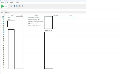

pico (ping)'s password: (then, enter luckfox)
-> Access denied

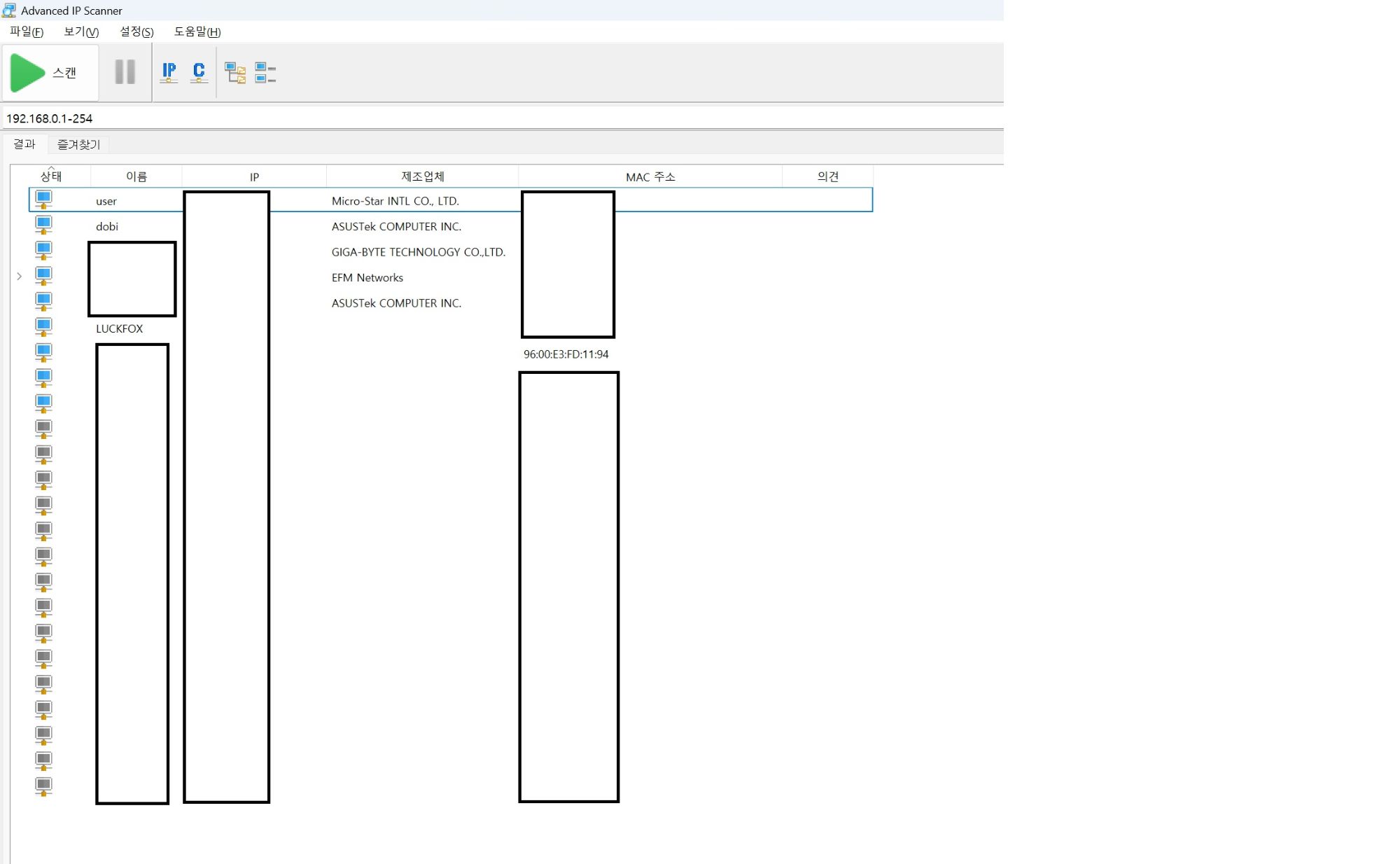

I found the IP of the Luckfox device using an IP scanner, as shown in the first image. Then, I used MobaXterm to connect to the Luckfox Pico device by entering its IP address. However, when I entered 'luckfox' as the password, I received an 'Access denied' message, as shown in the previous screenshot.
The latest images of the network disk have SSH enabled by default. If you can scan the IP normally, you can connect normally. Please log in according to the Wiki login account and password. If you cannot log in, try ADB or serial port login and use the ping command to check whether the development board and the computer are in the same LAN.
