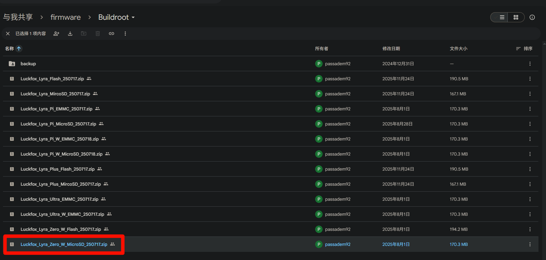

Luckfox Lyra: We do not offer support for Debian. The Debian-HDMI-USB HOST.img is a boot image used on the RK3566.
Based on your screenshot, the various test results are mixed together. We will first solve the problem of SD card booting.
1. Go to https://drive.google.com/drive/folders/ ... aezHE62P4z and download the illustrated image. Extract it.
2. Then download https://files.luckfox.com/wiki/Omni3576 ... _v1.78.zip with the tool. Insert the USB drive into the computer to let SDDiskTool recognize it. Select Luckfox_Lyra_Zero_W_MicroSD_250717/update.img, click SD Boot, and then click Create.
3. After the burning is completed, you can insert it into Luckfox Lyra Zero. Observe if the indicator lights start flashing. If they start flashing, it means the kernel has been entered.
First, go through this process. If you encounter any problems, please save the screenshots and upload them to my reply. Do not perform any other operations, including using RKDevTool.
