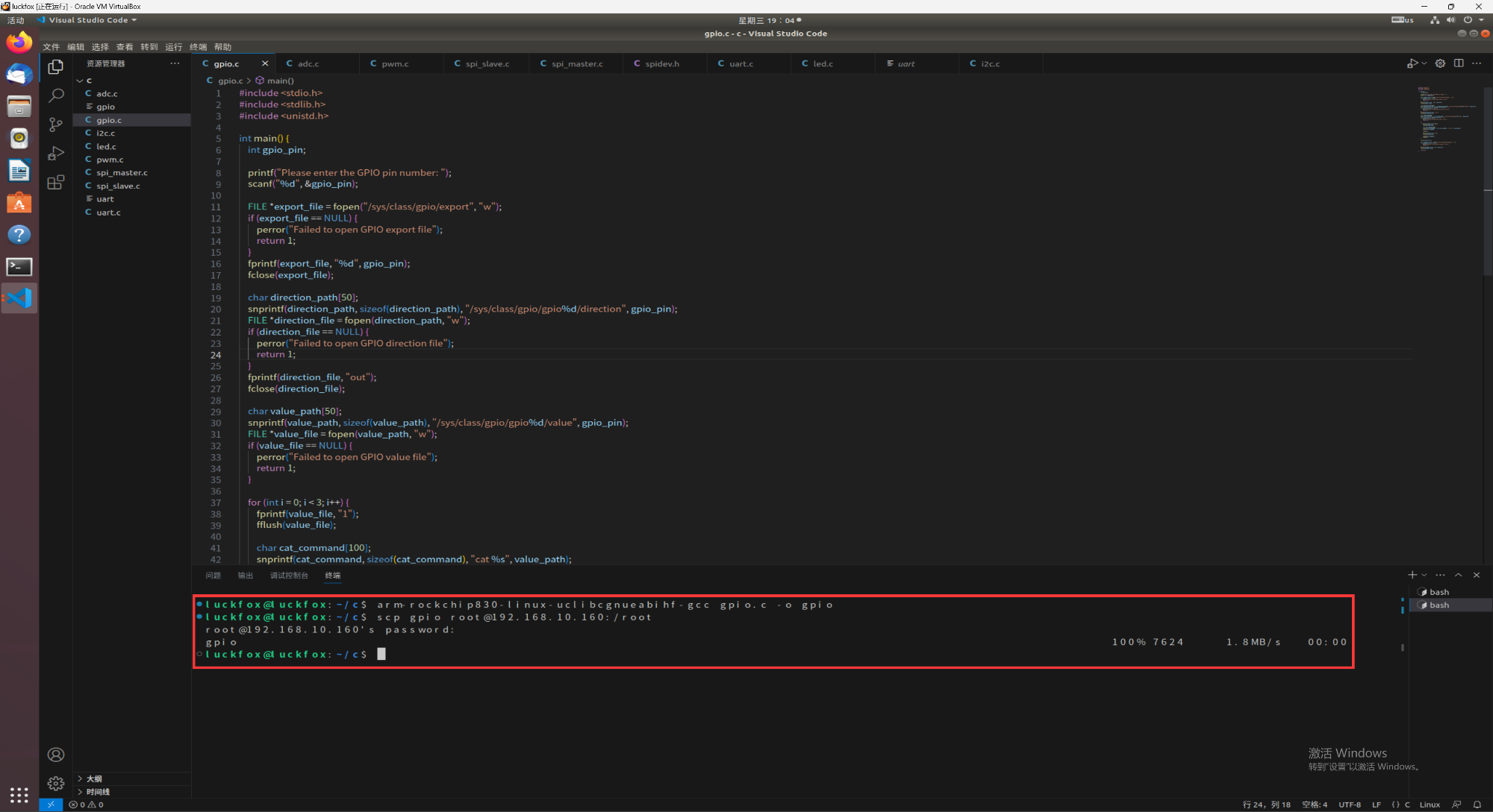

You can indeed install "Visual Studio Code" within a virtual machine to edit your programs and carry out cross-compilation processes. After successfully cross-compiling the application, the produced files should be transferred to the development board for running by utilizing SSH protocol.

When using Visual Studio Code to perform cross-compilation of programs, it is essential to add the necessary cross-compilation tools, which may require you to manually modify VSCode's configuration files. It is suggested that you use VSCode for code editing while referring to the methods provided on the official website for cross-compiling individual programs or projects.
