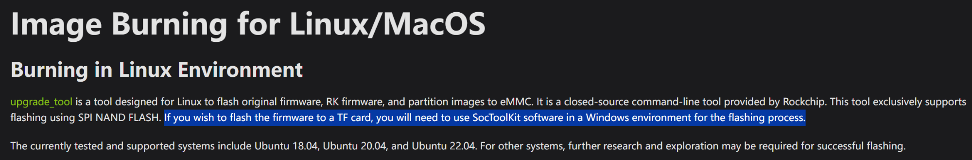

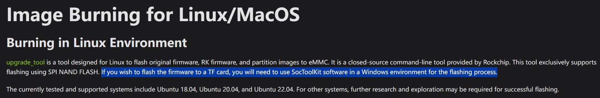

  • If you wish to flash the firmware to a TF card, you will need to use SocToolKit software in a Windows environment for the flashing process.
    https://wiki.luckfox.com/Luckfox-Pico/L ... urn-Image/

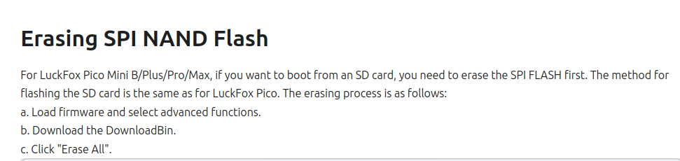

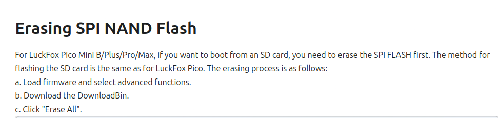

    I just wanted to mention that the docs don't seem to match what you are saying here @Eng38. Unless the wording is confusing the docs indicate to me that you MUST erase the flash before the SD card will work. This is an important distinction because sometimes it is very difficult to tell whether or not you are booting from SD or flash.

    If there is a mirror image in the SPI NAND and an SD card with a mirror image is inserted, the SPL in both the SPI NAND and the SD card will be the same, but the boot ROM will prioritize using the SPL from the SPI NAND. However, within the SPL, the storage media priority is higher for the SD card than for the SPI NAND. This results in the behavior where the system will attempt to use the image from the SD card first. But since the SPL from the SPI NAND is used, some initialization steps for the SD card might be skipped, leading to certain SD cards failing to be recognized, and ultimately the system falls back to using the image from the SPI NAND.
    To ensure that the image being used is the one you actually intend to use, it is recommended to erase the SPI NAND before using the image from the SD card, as mentioned in the wiki.
    The issue has already been preliminarily resolved and will be fixed in the next SDK update.
