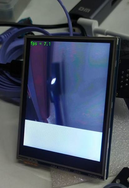

    I have finally got interface with LCD 3.5 and Luckfox Max.
    The last code which you provided the LCD was running ok
    Now,i want to import the camera image to LCD 3.5 ,if there is any code please provide
    Thank you very much for your help
    The good news is that currently the adaptation work is progressing smoothly, and there are still some minor problems to be solved. Please wait patiently, I will upload the code to github and inform you as soon as I finish it.
  • The face recognition demo supporting Pico-Restouch-LCD-3.5/2.8 has been uploaded to GitHub. You can directly download the compiled output file luckfox_retinaface_facenet_spi_demo_for_promax from the following link:
    https://github.com/luckfox-eng29/luckfo ... et/cpp_spi
    To compile the code, please modify the CMakeLists.txt file in luckfox_pico_rknn_example/tree/master/example/luckfox_retinaface_facenet/cpp_spi. You need to remove support for Luckfox Pico Plus (as its pins are different from Pro/Max). Comment out the line as follows:
    #add_definitions(-DLUCKFOX_PICO_PLUS)
    Then, follow the instructions in Readme.md for compilation.
