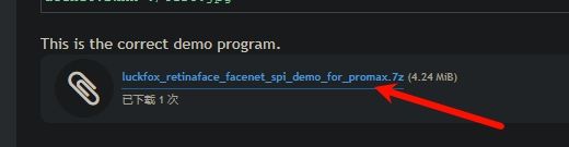

    Congratulations on reaching this stage, you're close to success! You've successfully loaded the RKNN model.
    However, I've noticed that you're using a program adapted for the framebuffer instead of one adapted for Restouch. This program fails to run because it can't find the framebuffer device during initialization.
    A properly adapted program for Restouch will output the type of development board.
    Please use the correct demo for validation.
     ./luckfox_retinaface_facenet_spi_demo_test ./model/RetinaFace.rknn ./model/mobilef
    acenet.rknn ./test.jpg
    This is the correct demo program.
    Downloaded 784 times

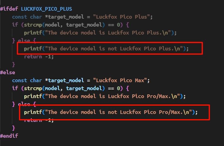

    I'm very concerned about whether you can run the program normally now. Can you tell me if you can run it normally?
    1.If you need to use Luckfox-Pico Pro/Max, you'll need to modify the CMakeLists.txt file because I've enabled support for Luckfox-Pico Plus by default. You just need to choose whether to keep the line add_definitions(-DLUCKFOX_PICO_PLUS).
    2.I've already specified the location of the output folder in the CMakeLists.txt file. After compilation, you can find the output folder luckfox_retinaface_facenet_spi_demo in the parent directory (example/luckfox_retinaface_facenet/cpp_spi).
    3。I'm not sure which folder you're referring to. The attachment in my previous response contains the compiled output files, and the compilation work was all done in luckfox-pico-rknn-example/example.

    Did you use this demo I provided?
  • Yes sir,
    I have downloaded the code,
    Here is my doubt ,
    1.Do i have adb push luckfox_retinaface_facenet_spi_demo_for_promax to my DevBoard or
    adb push luckfox_retinaface_facenet_demo?
    if so then confirm?
