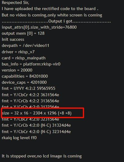

Respected Sir,
I have uploaded the rectified code to the board .
But no video is coming,only white screen is coming
.............................Output i got........................
input_attrs[0].size_with_stride=76800
output mem [0] = 128
Init success
devpath = /dev/video11
driver = rkisp_v7
card = rkisp_mainpath
bus_info = platform:rkisp-vir0
version = 20000
capabilities = 84201000
device_caps = 4201000
fmt = UYVY 4:2:2 59565955
fmt = Y/CbCr 4:2:2 3631564e
fmt = Y/CrCb 4:2:2 3136564e
fmt = Y/CrCb 4:2:0 3132564e
size = 32 x 16 ~ 2304 x 1296 (+8 +8)
fmt = Y/CbCr 4:2:0 3231564e
fmt = Y/CrCb 4:2:0 (N-C) 31324d4e
fmt = Y/CbCr 4:2:0 (N-C) 32314d4e
rkaiq log level ff0
It is stopped over,no lcd image is coming
- Posts: 2018
[email protected] wrote: ↑2024-03-26 10:25
Respected Sir,
Init success
driver = rkisp_v7
version = 20000
rkaiq log level ff0
This is the normal running print message. You can compare and see if there are any issues. It seems to be related to the camera. Please check if any programs related to the camera are closed or restart the device.

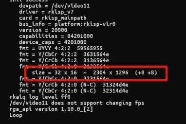

- Posts: 2018
[email protected] wrote: ↑2024-03-26 13:07
Sir,
I am using SSC3336 camera,
I have tested the camera earlier it was showing output in the VLC player
But now it is not showing
Based on the initialization results, the main issue seems to be related to camera initialization. During the initialization process in opencv-mobile, there are some camera-related information printed. One noticeable difference I found is in the resolution capture, which could be due to driver or initialization issues.
If possible, please provide the output of <b>'dmesg'</b> command after allowing the program to execute.
This is the normal display situation.
Typically, resolving driver issues requires re-flashing the system. Please confirm the system you are using and attempt to re-flash accordingly.
https://drive.google.com/file/d/1OApBa ... rive_link

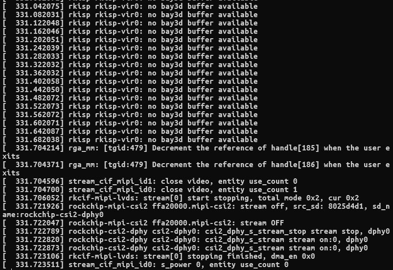

- Posts: 73
- Joined: 2024-03-19 8:46
Respected Sir,
After executing the code,
i have entered the #dmesg
this is the output
op 0
[ 4.993052] 755: MPP_ENC_SET_CFG in
[ 4.993067] 524: MPP_ENC_SET_RC_CFG bps 7776000 [7290000 : 8262000] fps [30:30] gop 0
[ 4.993214] 755: MPP_ENC_SET_CFG in
[ 4.993229] 524: MPP_ENC_SET_RC_CFG bps 7776000 [7290000 : 8262000] fps [30:30] gop 0
[ 5.021962] 1062: mode cbr bps [480000:512000:544000] fps fix [30/1] -> fix [30/1] gop i [50] v [0]
[ 5.059137] dwc3 ffb00000.usb: device reset
[ 5.210146] rkisp queue buf done
[ 5.245777] vepu_pp_create_chn 0
[ 5.316131] android_work: sent uevent USB_STATE=CONFIGURED
[ 278.416315] adbd (476): /proc/476/oom_adj is deprecated, please use /proc/476/oom_score_adj instead.
Please suggest if any modification or changes to be done,as still no LCD display is coing
- Posts: 2018
[email protected] wrote: ↑2024-03-27 5:47
Respected Sir,
this is the output
op 0

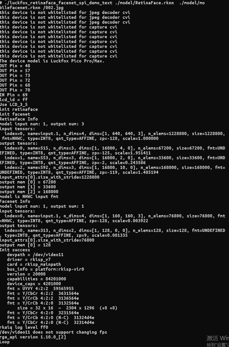

Please double-check the details:
1. Re-flash the correct image to the spi_nand.
2. Boot up and execute "killall rkipc" to release the camera occupation.
3. Use adb to upload the demo output folder provided by me to luckfox-pico.
4. Use adb to upload a picture of your choice to luckfox-pico.
5. Navigate to the demo output folder and execute "./luckfox_retinaface_facenet_spi_demo_test ./model/RetinaFace.rknn ./model/mobilefacenet.rknn xxxx.jpg" (Replace "xxxx.jpg" with the address of the picture you uploaded).
If the issue persists, please try simpler demos. This demo might be a bit complex for your current level.
