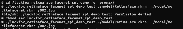

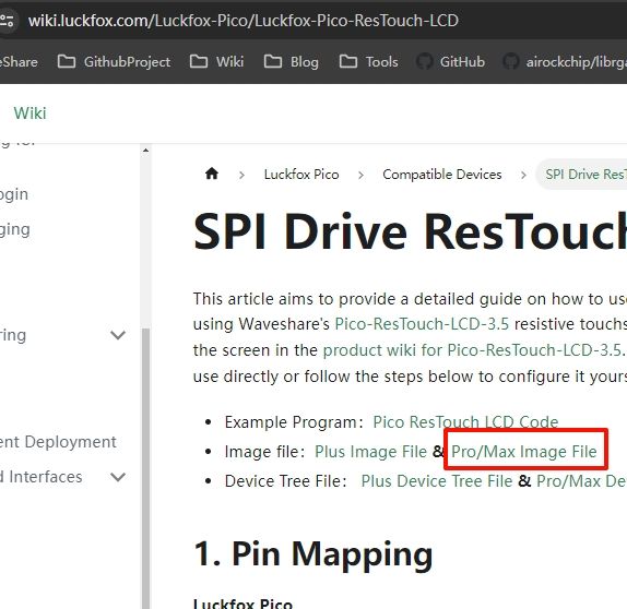

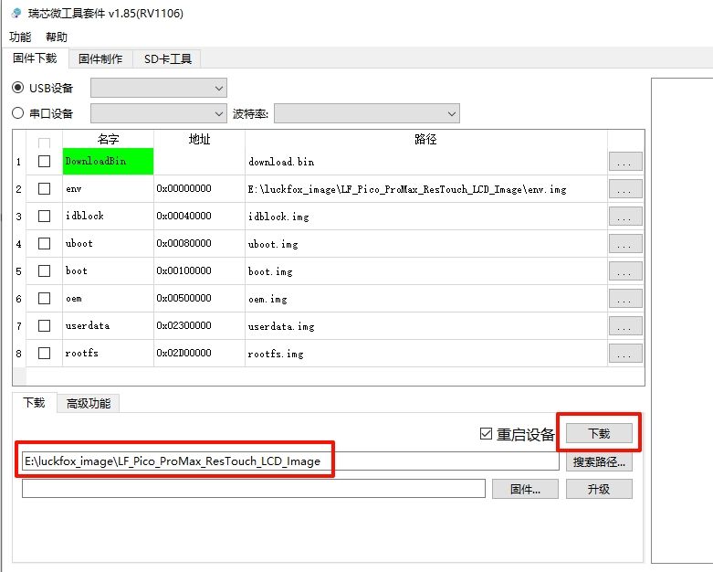

Sir, I have taken screenshots of all the steps I performed. Please compare them to see if there are any differences:
1. Open the link https://wiki.luckfox.com/Luckfox-Pico/L ... sTouch-LCD and download the corresponding image. 2. Use a download tool to rewrite the image. 3. Confirm the machine's operational status and shut down the rkipc program. 4. Upload files from Windows to the root directory (/) of luckfox-pico. 5. Upload a facial image to the root directory of luckfox-pico (you can choose any image you like). 6. Execute the program. Since my image is placed in the root directory, I use /002.jpg. Finally, this demo may be too complex for you. I sincerely suggest that you start with simpler experiments. There are many interesting and simple experiments provided on the wiki.When you have sufficient Linux development experience, using this demo may yield greater rewards.
