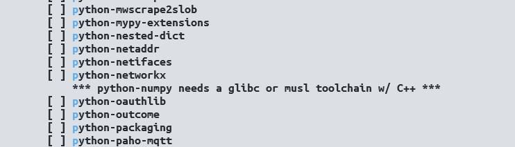

Hi all,
I using luckfox pico plus with builroot. Now I want to install numpy for my work. Could you please help me to install numpy?

In the context of Buildroot, when prompted to add NumPy, which requires a dependency on glibc, but LuckFox-Pico's system is built upon uClibc, it indicates that incorporating NumPy directly might not be feasible due to its reliance on glibc.
