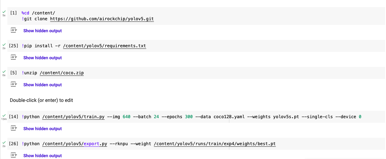

Workflow:

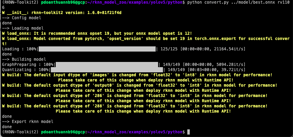

After that, I obtained two files: best.onnx and RK-anchors.txt.
I placed the model on an Ubuntu machine and converted it to an RKNN model:
Configuration: I changed the labels list to include only "person" and updated the anchors to match those in RK-Anchor.txt. After converting, I added the model to the rkmpi-example (https://github.com/LuckfoxTECH/luckfox_ ... pi_example), compiled it, and ran it. However, I encountered an error:
